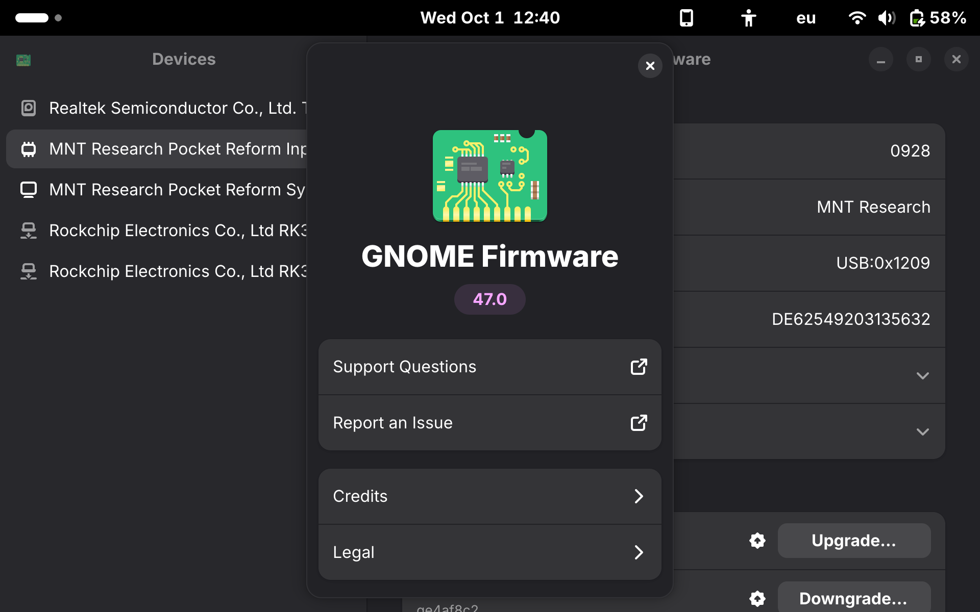

MNT Pocket Reform Firmware Update
Lucie discovered the reason for System Controller hanging after poweroff: SPI handler is called every 5ms in a timer interrupt. The poweroff contained a sleep_ms(10). sleep_* is forbidden in IRQ handlers in pico-sdk. This bug is now fixed! Lucie also combed the keyboard firmware for sleeps and removed sleep_us(1) from the main scanning routine. Thanks to a push by Chris Hofstaedtler, we got keyboard firmware updates in fwupd/lvfs as well now.
And another bug was fixed: Lucie had a hunch of using cppcheck on the MNT Pocket Reform firmware code, and they found and fixed at least one reason for keyboard crashes/resets: past them had snuck a strdup() call in the keyboard firmware (when printing specific strings to the OLED screen), so it would over time slowly run out of memory. You can view the details on our repo. This includes a hidden menu shortcut (M) to show free heap memory.
You can update your Pocket Reform firmware later today, when the version "20251001" becomes available in the GNOME Firmware application for both the keyboard and System Controller. Alternatively you can use fwupdmgr on the command line.
Screenshot of GNOME Firmware, a launchable program on Pocket Reform
