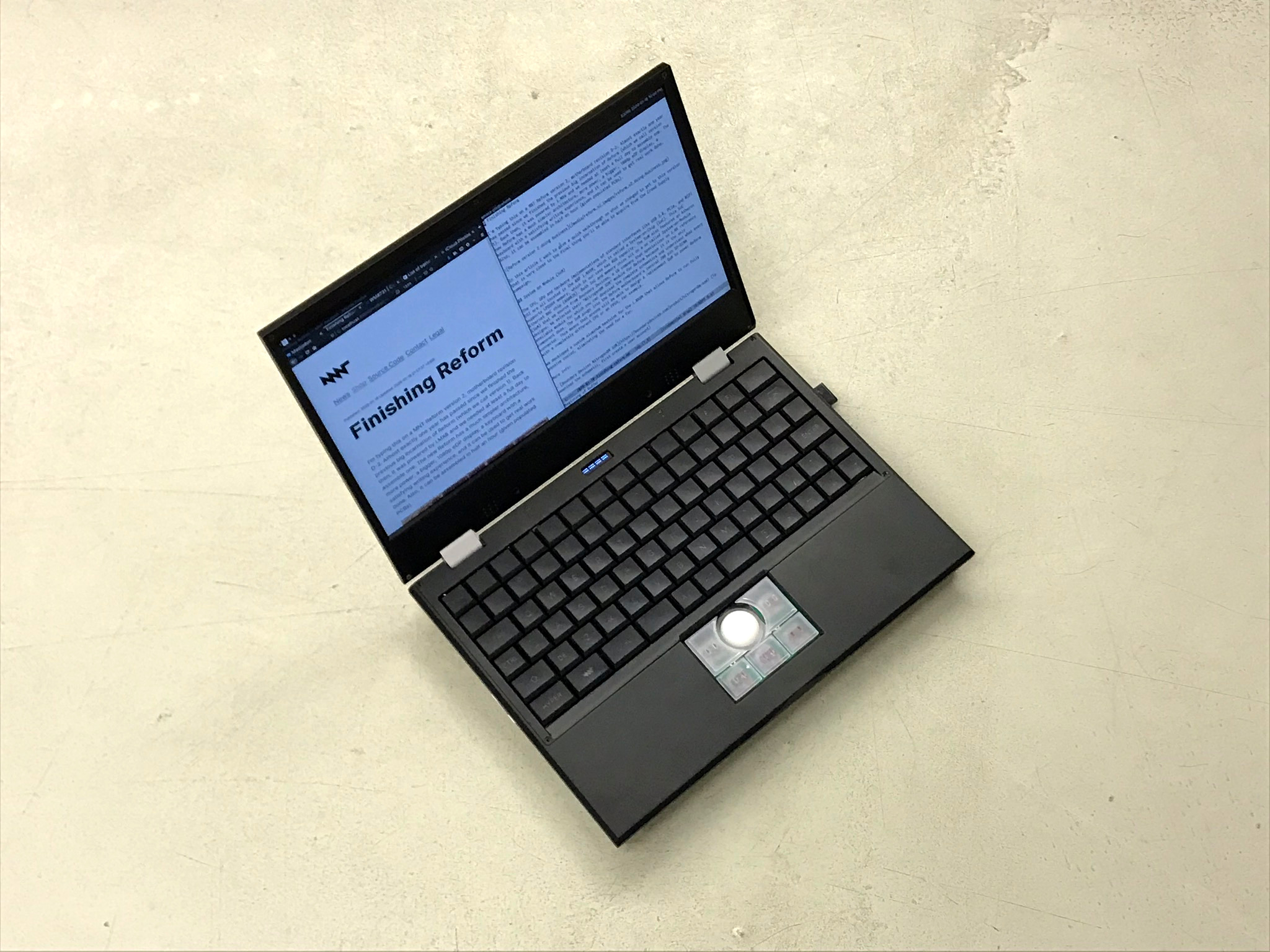

I'm typing this on a MNT Reform version 2, motherboard revision 2. Almost exactly one year has passed since we finished the previous big incarnation of Reform (which we call version 1). Back then, it was powered by i.MX6 and we needed at least a full day to assemble one. The new Reform has a much simpler architecture, more power, a bigger 1080p eDP display, a keyboard with a satisfying writing experience, and it can be used to get real work done. It can be assembled in half an hour (given populated PCBs).
Reform version 2 doing business

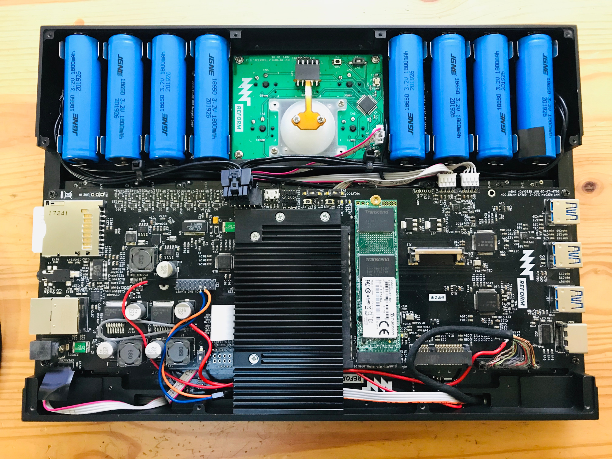

The CPU, GPU and hardware implementations of standard interfaces like USB 3.0, PCIe, and MIPI DSI are all located in the NXP i.MX8M, which is called a System-on-Chip (SoC). This SoC supports LPDDR4 memory, which in our case has 4GB capacity. The SoM features an Atheros Ethernet MAC chip (AR8035). Both SoC and memory chips sit on a System-on-Module (SoM) that we source from Boundary Devices, a US company that specializes on i.MX reference designs. We selected their "Nitrogen8M SOM" module for Reform because it is the only available module for which you can download the complete schematics and understand what every component does. The SoM plugs into the Reform motherboard's central 200 pin SO-DIMM connector. This means that anyone will be able to design a replacement SoM to power Reform with a completely different CPU or an FPGA, for example.
We developed a custom aluminum heatsink for the i.MX8M that allows Reform to run fully passive cooled, eliminating the need for a fan.

Motherboard
Reform version 2 Motherboard
The motherboard spans the complete width of the device (around 27cm) and ends with external ports on both sides. It has the following features:

Reform version 2 Prototype Bottom View
When not connected to a wall adapter, Reform is powered by 8x 18650 LiFePO4 battery cells. Each has a nominal voltage of 3.2V, and all cells are linked in series, which means an operating voltage of 28.8V. This arrangement has the upside that we can monitor and balance each cell individually. You don't have to factory-match cells like you would have to in a parallel arrangement. You can buy replacement cells for Reform for around 2.50 EUR. The LiFePO4 chemistry trades some energy density for many advantages:
